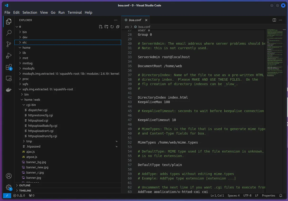

With the firmware loaded and tested, it was time to get into the weeds. Unpacking the zip archive from the vendor’s site, I found a .bix file. BIX is a less commonly used compression format used for packing firmware. Thankfully, BIX is just GZIP, so it was pretty easy for me to extract with a tool like 7-Zip.

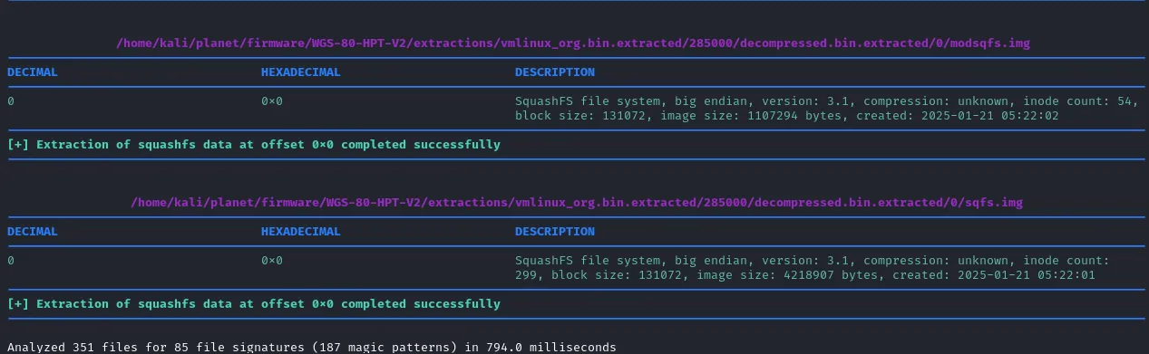

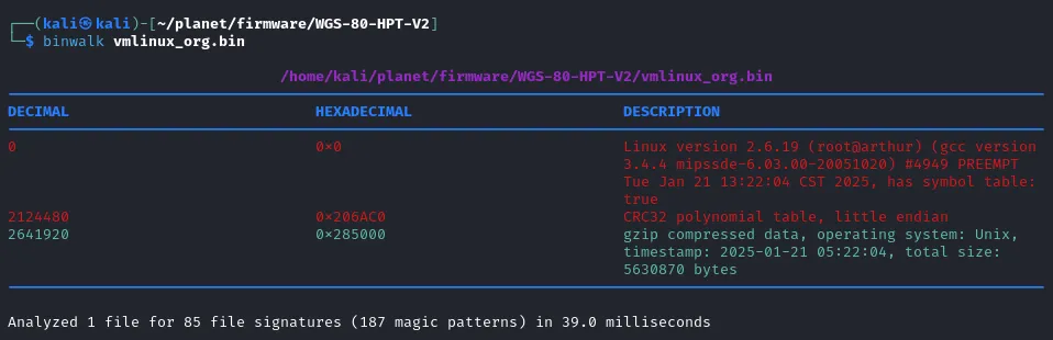

Unpacking the BIX archive, I got a single file, vmlinux_org.bin. For this one, I turned to binwalk.
Note: Binwalk v3 has been released and is a significant improvement over earlier versions. If you haven’t already updated, I’d make the transition. It’s an easy installation using crates, and is significantly quicker and less prone to false positives.
Binwalk gives two results: a very old Linux kernel and another GZIP compressed section, which most likely holds the file system.
I ran binwalk again with the -e -M  flags to recursively extract and scan the sections. This quickly provided several sets of files.
Looking at the extracted file system, there was a lot. It would take a while to review everything manually.

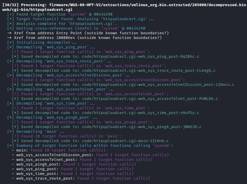

This is where I like automation. I want to look for low-hanging fruit, and most of the “fun” things are probably going to be in the binary files.
I wrote a Python script to automate a few of the more manual steps. It:
  • Scans a given directory for any ELF binaries
  • Creates a Ghidra project
  • Loads each ELF file and runs Ghidra’s default analysis
  • Searches for a set of functions and xrefs
  • If a function and xref is found, the decompiled code is written to a directory
The script found a few system calls across a few of the web CGI files. These were definitely of interest, as it’s possible they could be accessed from the web graphical user interface (GUI).

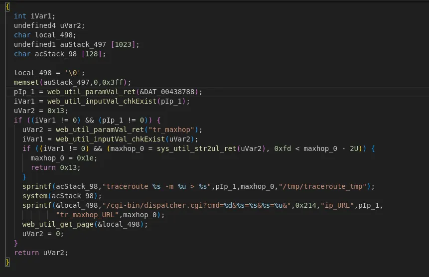

Checking the code directory that the script created for me, a couple of these function call results jump out as immediately interesting.
I needed to review this properly in Ghidra, but at first glance, this looks like a classic command injection vulnerability.
Spoiler! This is the first new vulnerability, CVE-2025-46272, a post-auth command injection vulnerability.
So I had something that looked interesting. From a cursory review of the code, it looks like it should be vulnerable, but I wasn’t yet sure if any sanitization had happened earlier in the process.

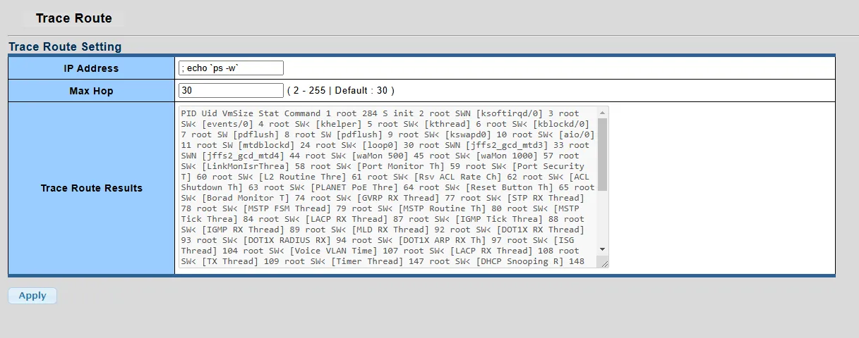

The easiest way is to test this dynamically in a tool like Burp. But first, I had to find out where this page was in the application.
As it turns out, this function wasn’t actually available from the menus in the application. It might have been a leftover tool or maybe a function for another switch that shares the same code base. Either way, the function exists, and I could manually navigate to it.
Without going too deep, the web application uses a cmd value to determine which page to load. In this instance, looking at the code, you can see that the function loads a new page dispatcher.cgi?cmd=%d. You can also see that 0x214 or 532 gets passed to this URL string. This is what I used to find the “hidden page”.
Grabbing the cmd value for this page, I opened it in a browser and got my first look at the trace route page.
Then it was time to load up Burp to see if I could get a command injection here.
Turns out – yes!
http://172.21.1.100/cgi-bin/dispatcher.cgi?cmd=532&ip_URL=; echo `ps -w`&tr_maxhop_URL=30&

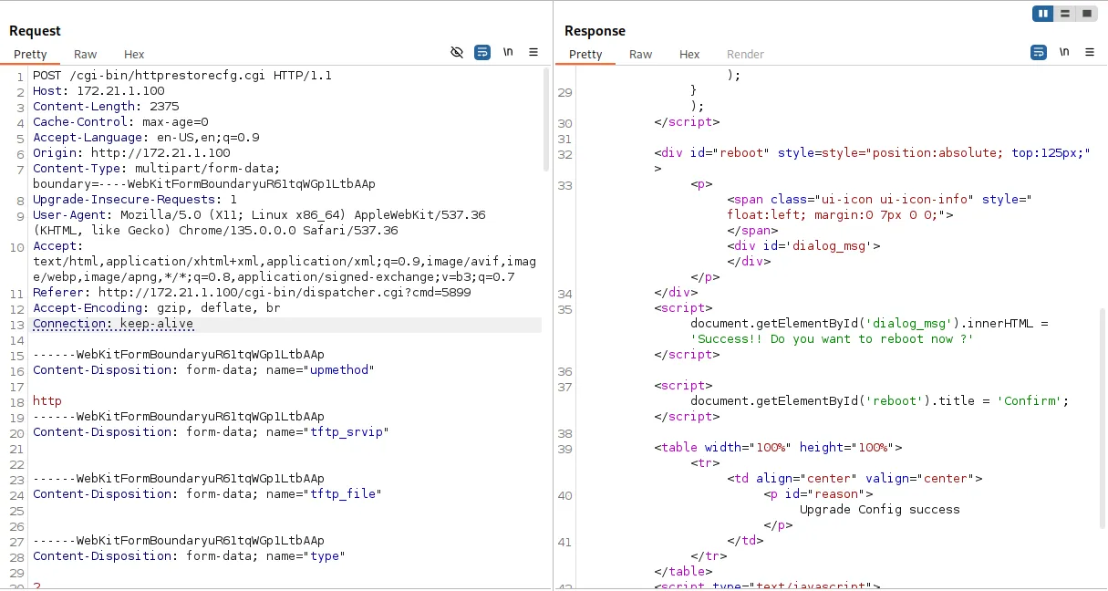

So I took to Burp and started looking for logic flaws or bugs in the auth flows and file uploads. Could I abuse these to get a shell on the host or bypass the login flow?
As you probably guessed from this very leading statement, both of these things turned out to be true! This was the second vulnerability, CVE-2025-46275, an auth bypass on WGS switches, which chained quite nicely with the OS command injection vulnerability.
I was in Burp Repeater looking at the uploader for the configuration file. I was tampering with some header fields and accidentally deleted the cookie from the header when I was removing some of the browser-populated values. I sent the POST request, and it was successful.
It was actually the next day when I realised what I had done. After powering everything back up and returning to Burp, I jumped straight into the repeater that I’d left open and just hit send. To my surprise, it just worked!
The session files are stored in /tmp, which gets emptied out on reboot, so this attempt should have redirected me to the login page. But it didn't; it was successful!
First request with the session cookie
Second request with the session cookie removed
There are many vectors here with auth bypass on file upload. I could have flashed custom firmware to take complete control over the device (I might save this one for a later blog post…) or I could have manipulated the configuration to change how the device operates.
For the sake of a clean and impactful PoC, I decided to go with creating a new admin account.

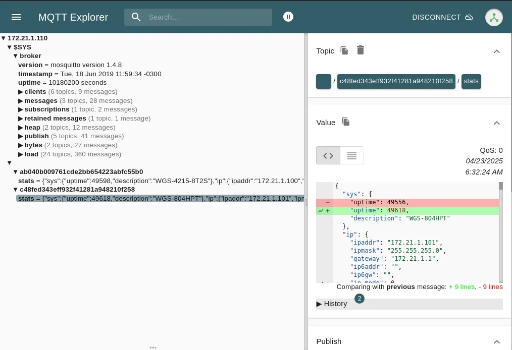

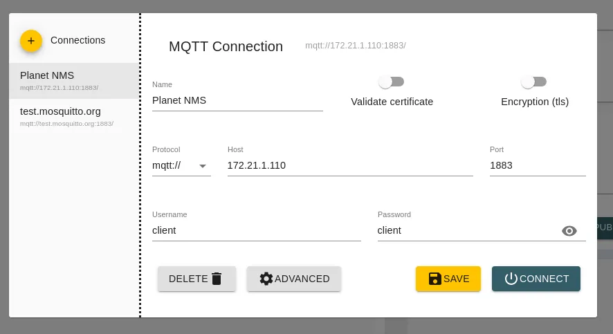

With a local NMS connected to the network and each of the switches configured and communicating, it was time to see what I could do without hard-coded credentials.
My go-to tool for quickly reviewing MQTT servers is MQTT Explorer. It’s cross-platform and pretty easy to configure.
Normally, when using a protocol like MQTT, you need to subscribe to specific channels to see what traffic is being sent. Fortunately for me, it appeared that our MQTT setup automatically subscribes to channels, meaning every time a device communicates with the MQTT server or the NMS server sends a command to a managed device, we also get a copy of the data.
The impact of this vulnerability depends on the types of devices being managed and their capabilities. At best, this is an information gold mine for threat actors, discovering all the assets and their configurations. At worst, attackers can publish messages to devices that will override their configuration.

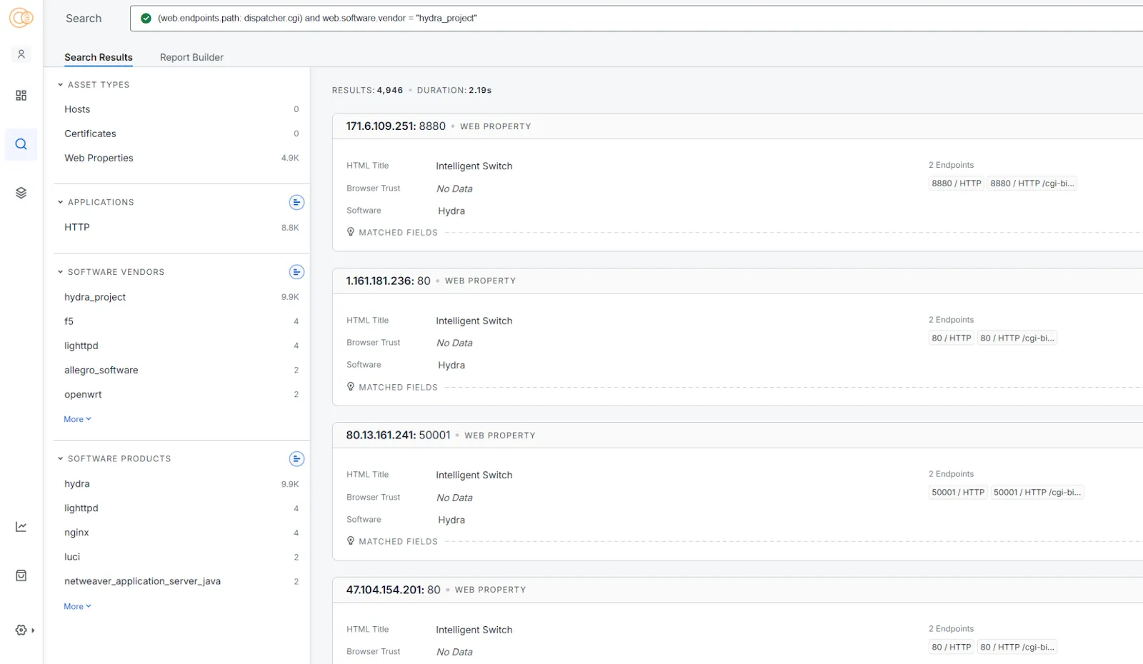

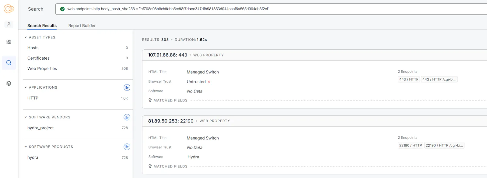

I took two approaches here. The first was a bit of a scatter-gun approach that would find likely Planet devices, but wouldn't be able to validate the version (and could pick up other devices).
This first search was for a web path dispatcher.cgi and the server software hydra. This resulted in around 5,000 results.
A scan showed these were definitely Planet devices – or they at least shared the same URL structure, server software, and HTML title – but from the results, it was difficult to tell what devices they were specifically.
The second search was more specific. Censys allows you to search using the SHA256 of the HTML. This should be pretty effective as the default pages for both switches were static with no dynamically-generated elements like a timestamp. This was an easy search with two steps:
  • Get the SHA of the landing page with curl http://172.21.1.100 | sha256sum
  • Search for the resulting hash
808 results this time round! Again, it was hard to identify specific versions, but there were going to be Planet switches, most likely in the WGS series.
Search interface showing 808 web properties with details of two managed switch endpoints and software info.
I made a lot of assumptions when reviewing these results, especially using passive tools like Shodan and Censys. With more active recon, it’s possible to fingerprint the specific versions and identify internet-connected devices that would be vulnerable to the CVEs detailed here. But that’s outside the scope of this report.
